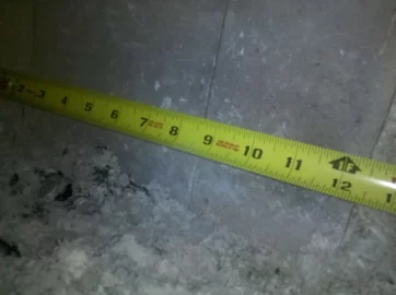

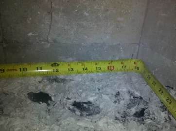

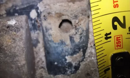

[Hearth.com] Napoleon stove max wood size? Catching up, I was on vacation.

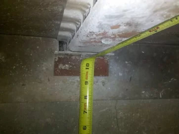

Napoleon 1100 from floor to top of burn tubes, About 10 1/2 inches.
East / West or left right is barely 18, best is 16, 17 1/2 is the most to give a little wiggle room.
North / South or front to back is 12 inches but again unless it's a perfectly straight cut I stuck with 10 - 11 inches.

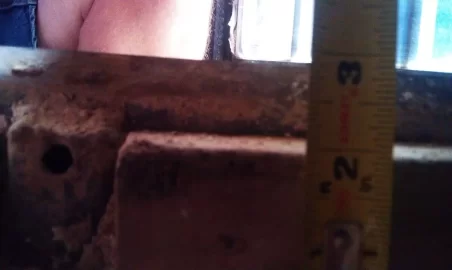

The floor is not too deep, the bottom of the firebrick floor to the air inlet is only two inches and to the top of the lip is close to 3 inches. [Hearth.com] Napoleon stove max wood size?

View attachment 71693 Catching up, I was on vacation.
The floor is not too deep, the bottom of the firebrick floor to the air inlet is only two inches and to the top of the lip is close to 3 inches. View attachment 71693
