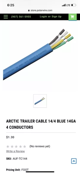

The 4 wire is available in the Arctic flex i stock it all the time... you can even get the 4 wire round plugs they are used on the weigh scales on logging trucks... That's all we sell now i got rid of all the cheap wire and most of the time i sell it by the 250ft roll. It comes in 2-7 wire versions
Reactions: Don2222
Wow, that stuff looks amazing! :-)
Thanks
Are there 4 wire plugs with that wire on them?
[Hearth.com] Need a little trailer wire help?
awesome- that is exactly what I use in the 7 conductor. once I tried it - all I use on my trailers.
awesome to know what is available - I will let the company I drove log truck for know about it - they would benefit a lot - thanks for carrying that cable!
