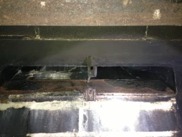

Here's what I'm working with. Also, is it possible that my chimney isn't actually 8"? It's hard to tell but it doesn't appear to be if so. The flue is only about 6" wide as well which is going to make getting an 8" flex through difficult. Would I be ok if I just ended the outlet elbow right under the flue flap and surround it with insulation? I appreciate the advice so far. [Hearth.com] Need advice on older VC Defiant [Hearth.com] Need advice on older VC Defiant [Hearth.com] Need advice on older VC Defiant [Hearth.com] Need advice on older VC Defiant [Hearth.com] Need advice on older VC Defiant [Hearth.com] Need advice on older VC Defiant
