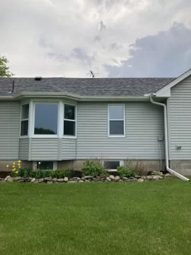

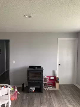

I purchased a Drolet Deco ii wood stove for our living room. I understand all the clearances in the manual from the back of the stove to the wall depending on single or double wall up to the ceiling. I’m good on ceiling height to the top of the stove. Left or right I don’t need to worry since I have 6’ of clearance. I also understand the hearth clearances every direction as we will be doing some sort of slab of stone. My concern is once I get the pipe up to the ceiling what do I need and what clearances? I will be doing a straight vertical run up to the ceiling through the attic out the asphalt roof. My attic space is about 4-5’ of vertical run. What parts do I need? Is there any type of clearance I need to make from the rafters and sheathing? Do I need to contact a local building code inspector in my county to get this precise info? I remodeled homes for 10 years in my youth so I have a great understanding of construction but nothing when it comes to wood stove venting. Vent will be coming out of the roof below the tv antenna. Approximately 56” of stove pipe from the top of the stove to the ceiling. Thank you for the help.
