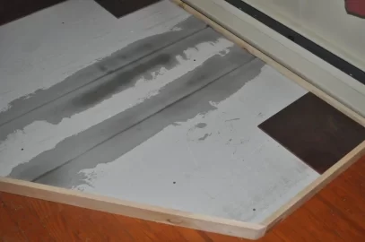

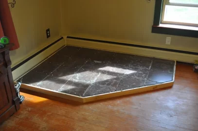

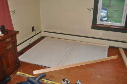

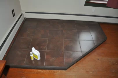

Well a little later than promised but here are some pictures of the final product.
Brian
  • [Hearth.com] Need help today.  Updated with completed hearth photo's
Very nice indeed, looks like you won't be needing those baseboard heaters any more. What did you use to trim out the hearth?
It's edged in pine that is painted. I am adding a 1/4 inch twisted square bar around the center of the pine when I get a chance. Just to dress it up a tad.
Thanks for the comments.
