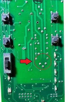

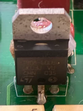

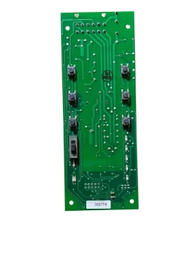

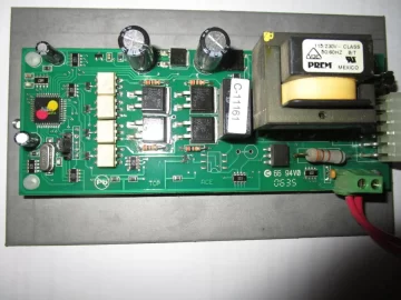

When either of the yellow wires attaching to the vacuum switch are removed, the auger does stop. I inspected the wire harness & didn't see any problems. When I looked at the control board a little closer, there is an ever so slightly discoloration (photo). Photo D is what is on the other side of that area.
So my hunch is that it is a control board issue. It was mentioned that they are repairable (which is more attractive than a new $400.00 board), Do members here offer this service?
