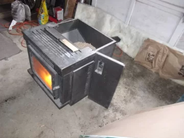

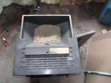

need help .... which manufacturer and model could be this oven?
Coyote_nb_ca
Hi,
catch for little money this oven...​
[Hearth.com] need  help .... which manufacturer and model could be this  oven?
I don't know the first thing about it.
looking for manual etc
must be some years old

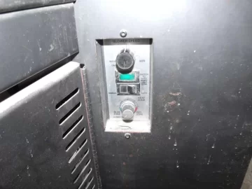

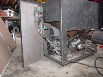

make a first fast clean job on it and must bypass the vacuum switch (clean the tube and the hole to the exhaust pipe)
the last owen bypass the blower switch. will see what my meter say ...

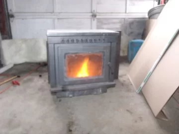

a first test run show up
hot airflow feels poor
i think he was running on blower 100% and feeder on a middle to high position.
garage (35x15food no isulation) holds on 60F outside 36F
maybe will make a good 2. stove for the rest from the house..
thx for any help on it

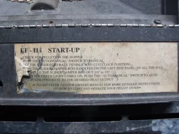

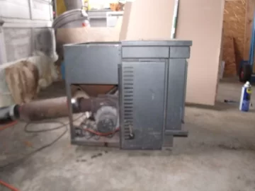

It says right on it. It's an Enviro EF II (two).
It's an insert model. Not freestanding.
They were known as a good stove. Clean it well. Compressed air, lube motors, and check gaskets.
A very good stove, EF2I parts are readily available, simple to use and maintain. Rated at 35K btu good for about 1200-1500 sqft here in Ct.

pls the vacuum hose on the top (low) connection or in the down (high) one ??
maybe need some parts later ..
thx
fred
hi don,
thx
fred
Most of the pellet stoves use the top low connection.

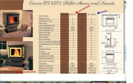

Hey Scott, You need to study your stoves a little more. If you have any questions let me know.
I rebuild stoves not just fix them!
FPI = Fire Place Insert
Enviro EF-2 FS = NO ignitor
Enviro EF-2i FS does mean Ignitor! ! !
See my red and blue arrows in the Enviro Info below.
Click to enlarge.

They also make the EF3bi which stands for "built in" which was the first and one of the few which are approved for zero clearance
No Scott, the EF-3Bi FS stands for Bay View ! ! ! LOL
Also it is not zero clearance without the optional zero clearance kit
OPTIONS
  • 24Kt gold door cover.
  • Nickel door cover.
  • Zero clearance kit.
