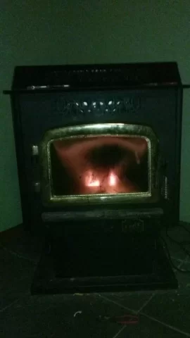

Hi, I got a st. Croix pellet stove that came with a house I had bought but has no manual. Lately the stove doesn't seem to push as much heat out as it did the first time I used it. The flame will die down than shoot back up to the top of the stove along with shooting sparks everywhere while it's in the process of turning the glass black to the point I can't hardly see anything so I have to clean it every time I burn a bag. So I'm curious what I'm doing wrong.

Can you post a pic so we can help?
I'm not sure what model it is.

Hello
Model looks like a Prescott
This model has 2 holes, one on each side of the pellet drop chute above the burn pot behind the fire brick.

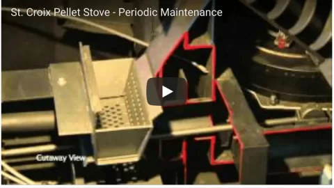

The St Croix "Periodic Maintenance" video for St Croix Prescott EXL has a cut away stove and shows a very brief cleaning the holes behind the fire brick with an auto or lawn mower choke cable!! I still like the leaf blower trick better!
See pic of freeze frame below! Pic shows choke cable in hole on left side of pellet drop chute.
Video goes too fast over this point! Also says to use a cordless drill and old lawn mower choke cable to clean these holes. I used a compressor and a leaf blower and disconnect the vacuum switch to prevent damage to it. See choke cable in pic below.t
