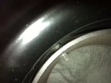

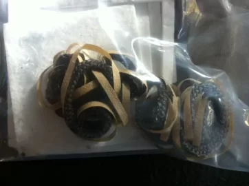

Frostbit, did you have a gap similar in size to the photo below? I've also included photos of the adaptor and the gasket material that came with the stove. I assume the rope type gasket material (which is a peal and stick type) is for the stope pipe adaptor.
Any info/tips about installing the adaptor onto the top of the stove with a good seal would be appreciated.
Thanks.

My double-wall stove pipe is a special order which hasn't arrived yet. I opted for a telescoping section with a range of 38"-68", allowing me to install just one piece from my stove to the chimney adaptor at the ceiling.
The issue is the fit between Jotul's stove pipe adaptor and the cast stove flange fitting on the top of the stove. I suspect the reasons Jotul designed the adaptor to be larger than the cast flange were to allow room for a gasket and because the cast iron and the sheet steel adaptor probably expand/contract at different rates.
Jotul has adapters for several of their stoves because in Europe there are a lot of five inch stove pipes.
