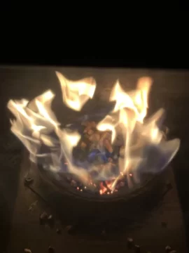

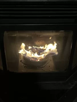

My wife and I bought a house with a 1200 Classic Bay stand alone in the basement. The month I have owned this house I have did nothing but troubleshoot this stove, at first it was shutdowns continuously. It would run and then shutdown so I replaced the thermocouple. Then the stove still would not operate. I had a maintenance guy from a chimney service in CT, come out. He unplugged and plugged the machine a few times to the wall and then said I had two wires crossed on the thermocouple, so he switched them and called it good after it operated normally for him for about 30 minutes. My pellets fill up the burn pot, quickly, after four hours it’s full of black pellets to the rim. I have cleaned the exhaust blower out and it was filthy and cleaned the fire pot like a crazy person continuously, can anyone help? Any advice is appreciated. I’m defining insanity daily it seems. I have read the tech manual cover to cover as well, I have it on my phone. I do not know how old the stove, that’s my only thing. I have attached pictures of my problem and the pellets I burn.

Overfilling is usually dirty/restricted exhaust, from inside stove all the way to end of flue.
What happens when you set pellet feed to low?
Reactions: tphelps1
I cleaned the space behind the exhaust fan where you can see the convection fan vanes but it still overfills. The chimney guy didn’t clean the whole exhaust system, but no one has cleaned the whole exhaust system as far as I know. When the feed rate is set to low it takes longer to fill up but still does.

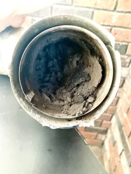

I have access to where my vent ends outside, so I use a leaf blower with a pvc adapter as shown below. The adapter slides inside the 3" vent and it sucks all the ash out. Definitely blows out quite an ash cloud. If you do it this way just make sure your stove door is propped open some and you may want to unhook the vacuum switch since it is possible to damage it.

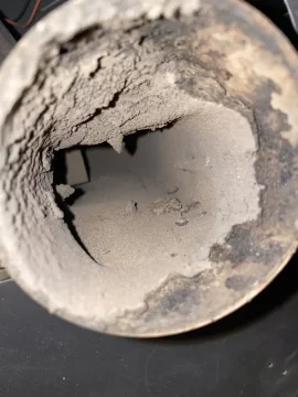

The "chimney guy" did not clean this lady's exhaust,either. She was having many problems--

WOW! That is crazy!
I cleaned mine yesterday for the first time this season (burned 1 ton so far) and I had about 1/16th of an inch all the way around mine.
