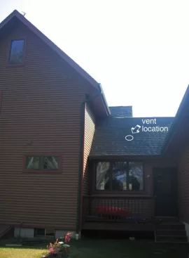

I am planning to install the vent pipe myself, and have decided a single vertical vent is my best option. Based on the attached photo, how high will the pipe need to be once it exits the roof?

My main concern is the adjacent roof, being so much higher in relation to the roof over the stove pipe.

As for the height - you need to be 1' above the roof where you exit. Not sure how close that other roof is but the next generally applicable rule would be 3' above any roof height within 10 feet (horizontally). Technically speaking (ref: NFPA 211) you'd be okay with the 1 foot requirement. From a drafting perspective, the 3' would probably be better.
