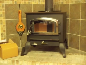

I have a Magnolia by us stove co. purchased at tractor supply , they're now about 900.dollars, worth every cent!
  • [Hearth.com] Need stove help...Please!

The magnolia is a good wood stove just need good seasoned wood as with all EPA wood stoves had mine for 2 or 3 years now.
