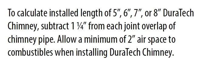

Are you sure? The catalog shows 60" being the full length including the connecting joint. It also says this:
[Hearth.com] Net length of DuraTech 6" double wall chimney sections?
