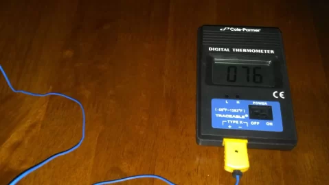

Any decent K-type Thermocouple will work.
Look on ebay? Or just search Amazon. Anything $40 or under will do.
I have a Cole Parmer. Works good. Very simple.
Just looked on eBay. The same model I have is less than $5 (I paid like $30 last year :()!! With .89¢ shipping!!!
Search Cole Parmer TM-902C K type thermocouple. Should come right up. Less than $6.00 shipped. I might buy another. Or three :)

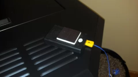

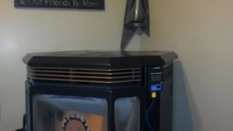

Mind snapping a pic of how it's hooked up to the stove?
It's not "hooked up" per say.
The unit can go anywhere. It has about 5' of probe. Just put the tip 1" from the end of your heat exchanger.
I put double sided 3M sticky tape on the back of mine and then added magnets. So it sits on the front of the stove (not Hot where it sits/that's actually a door panel thats on hinges). I have yet to start burning my Rocky Mountains (new pellet for me), so it sits in the drawer for now. Plus the probe that it comes with is pretty cheap. Im ordering a better probe type.
Once its set-up. Leave it in the same spot to measure output. End of season, remove and place in drawer till next season (new pellet brands).
