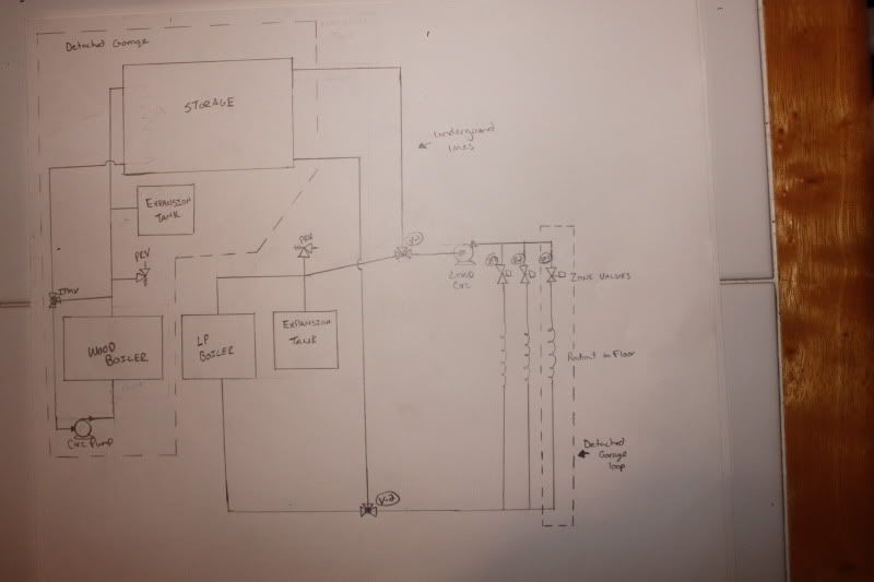

Ok so after doing some learning this is what I have come up with. Please tell me I am out to lunch if I am. Also my drawing skills may not be the best.
The wood Boiler and Storage tank is out in the detached garage. The propane boiler is located in the basement of the house.
I would like to only heat the storage tank from the wood boiler. This design means I will have to run 4 lines total from the garage to the house. 2 main lines when the wood boiler/storage tank is in use, plus the 2 lines for the loop of the garage itself regardless of which boiler is running.
The idea here is that the wood boiler heats the storage tank and it feeds the heating load. If the storage tank is above ~120F V-1 and V-2 will be open to the storage tank and the load circ pump will circulate the water to the zone valves that request it. The propane boiler will be disconnected from the system. When the storage tank drops below ~120F, V-1 and V-2 will switch and connect the system to the propane boiler. The wood boiler/storage tank will be dissconected from the system.
I am new at this, but willing to learn, please let me know what you think.
Thanks,
Jeff
