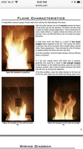

The C & D settins are for the 25pdv and pdvc only. Your lower 3 settings can be adjusted to fine tune the stove but always keep the last setting on 1. Try changing them to 3 4 1 and see if that helps with the burn. The ash build up will drop when you get the fire burning right.
