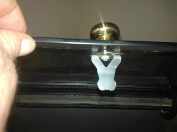

ordered the knob for the glass it came with a screw and thats it, i had already ordered the latch looking at the diagram there are no other parts
here it is with the screw fully tightened
[Hearth.com] new guy needing help
so i tried a shorter screw i had lying around and the latch hits the lip and doesnt line up with latch at all
i should mention i think this glass fits like crap, the edge hits the stove when you open it. when i had the screws tight on the glass it wouldnt close all the way because it was hitting the stove on the hinge end. i loosened it and shut it and tried to tighten the screws so it wouldnt hit but it still does.
Is there supposed to be a gasket for the glass to rest on? Maybe it is there, I see for cr*p :) Also, again not knowing anything about that stove, or seeing well, is the hinge for the glass on properly?
I'm looking at the pictures(broken link removed to http://hearthnhome.com/downloads/brochures/Advance.pdf), and your setup doesn't look quite the same is why I am asking those questions.
maybe it came with the wrong screw?

I almost went and looked at that stove (I'm in NH also) but found a different Advance. Here's a picture of my latch if that helps. looks like the wrong screw.
  • [Hearth.com] new guy needing help
Looks like a knob from a dresser looking at the length of the screw ... Who did you buy parts from?
