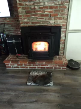

Greetings All!
We're happy to be brand new owners of a Harman 52i pellet stove insert. We had it installed yesterday, and although we're in New England and approaching spring weather, we're trying to get a little use out of it. Plus, we're excited to use it!
Having read the manual, I still have a few questions. While we've only had this thing running on and off for a few hours, I'm finding that it doesn't appear to be as hot as I had anticipated. The people installing it suggested to leave the fan setting and burn mode on auto, especially being a new user.
Any tips or recommendations that may help us? Do people have better success with keeping the fan on manual and set to a higher setting?
We're running Vermont pellets that were delivered from the same place from which we purchased the pellet stove. I apologize if I left out any relevant information, but if so, please let me know and I will update my post.
I've attached a pic for reference. Hope it works!
Thanks!

Congrats on the new stove. What settings are you currently on? Every situation is different so you'll receive many opinions. For me, I like feed rate set at 3, room fan on L, and temp is adjusted accordingly. I like room fan on L because it will ramp up when needed. In my opinion, if the room fan is on medium or high, warm air wil just be blown. I also run on auto. If in room temp mode placement of the room temp sensor will play a factor as well.

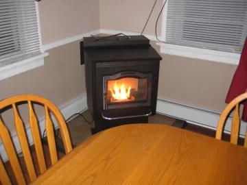

Pretty much what I do. We use Douglas fir pellets out West here. I clean it weekly, (except I was out of town last weekend). Do a deep cleaning monthly. Harman runs like a champ. we have an L shaped fireplace, so the probe is behind the Insert. It works for me. The cat enjoys it. :)

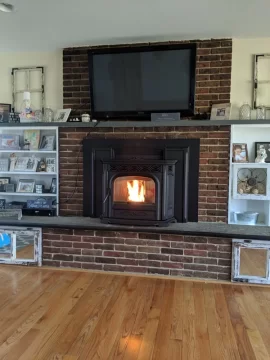

Nice stove I had the 52i-tc installed about 3 weeks ago in a 2300sq home and the boiler hasn’t been on yet. I also burn the same pellet Vermont I also just started burning Lowe’s Green Team they seem to be a pretty good pellets. I did need to turn down the feed rate from 65 to 55. Also if you don’t have it already I highly recommend the wireless Room Sensor. Made an huge improvement no the temperature I was looking for. Did you happen to get your stove from Fredericks Farm?

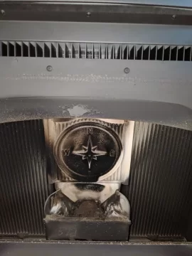

Appreciate all of the responses and help, everyone. Two things I've noticed now that we've had this for almost a week:
First, the room temp probe is sticking out at the top left of the insert, and this was set up this way by the installer. I was actually told to keep it there. It sounds like this may not be right? My concern on it being so close to the stove is that the temp is artificially inflated due to its proximity in location to the blower. I don't know how long the wire is, as I haven't checked it yet. I guess I assumed the person installing knew the best location.
Second, my wife noticed the paint inside the stove already flaking. We've only used one bag so far, as it's been in the 50's this past week. Is this normal?

Mine did the same thing I wouldn’t worry about it mine is only 3 weeks old. I also highly recommended the wireless Room Sensor made a big improvement on the temperature setting.

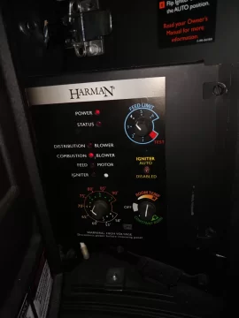

the sensor on my freestanding Harman is just peeking out above the hopper on the back left side.
[picture was taken back when i was exprimenting] with where to put it . had it all over the place before finding the sweet spot.. Your placement is fine.....:cool:

The 52i and also the XXV rely heavily on the blower to heat your room. You're not going to get a lot of radiating heat off of a 52i in my experience but yet it still heats your house. But on another note the blower is stronger yet quieter than say that of a P61 which gives more of a combo of radiated heat and blown heat. Added to that we are in the least demanding portion of the heating season right now, it will run hotter in January but even so other than the glass you will probably still be able to touch the cast iron parts of the stove.
