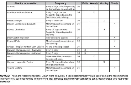

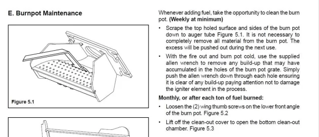

Has Harman changed the suggestion to open door and scrape pot once a day, even with fire going.
The chart shows every 3 bags (hardwood) and every 5 bags (softwood) - OR, every day. The cleaning description says when adding fuel or once a week.
Depends on the fuel and also can depend on what mode it is burned in.
With the Hastings I had to shut down daily to remove clinkers; Supposedly you could do it while the stove was running but I didn't' want to chance stray falling pellets producing sparks that could out the door, or even hitting burning pellets in such a way to create a fire hazard (my own paranoia most likely). With the Harmans I don't have to shut down as the bottom feeding screw stops.

Correct....
Reactions: bogieb
The Harmans will run dependably even if you do not scrape the pot daily. Ask me how I know....
Really though, Do the recommended cleans and pot scrapes and such as many do here and just turn that bad boy on and enjoy the plethora of heat and no baby sitting at whatever temp you like.
