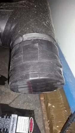

I checked last night and I had some smoke at start up at the bottom of the clean out T and at the clean out T where it attaches to the 3-4 increaser. Should I silicone them too?
I would use silicone tape on the bottom of the clean out T. Wrap a piece around the circumference, then stretch short pieces along the flat (attaching the ends to the circumference piece) , then wrap another piece along the circumference so it secures the ends of the short pieces.

It is very easy to remove when you need to get the clean out apart. The other I would just use tape too as that is the most likely place you would be taking it apart. But, you can use silicone in either/both places.
Home Depot stocks it. There are tons of it on eBay, where I got mine.
HD carries Stretch & Seal by Nashua (you'll find it in the tape aisle - not the heating supplies). Your local hardware store may carry it (or a similar product). Walmart carries Duck Wrap Fix and Amazon carries a whole host of silicone tapes such as Xtreme tape.
I added more silicone to the T last night. I'm giving it 24 hours to test it. That should give it plenty of time to cure up. I'm going to look today for some silicone tape as well.
I sealed everything up last night on the T with the silicone duct tape from Wally world. No leaks what so ever at this point in time. To bad the temp is in the 60's here now I can't test it again. Thanks for all the help guys!
