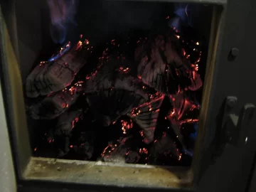

Hey JR, whats the upper part of the Kuuma firebox look like? I've seen pics of the lower part. It was being discussed recently on one of these forums about the different types of modern clean burn wood heaters out there. I said there is 3 types.
1 "tube type" where secondary air is brought in above the fire.
2 gasifiers where hot air is injected at a nozzle that the smoke/wood gas has to pass through into a secondary burn chamber
3 one with a "cat". Mainly stoves as far as I know
Not sure where exactly the Kuuma falls in there. I have heard the Kuumas being referred to as the only gassifying forced air wood furnace, but I don't know?
PM sent. I will attach this photo I took this fall about 1.5 hours into a burn cycle with the computer set to the lowest setting. It's definitely not as cool as those of you who have windowed doors. It's very hard to capture the "gassification" burn, because as soon as you open the door it disrupts it. I have singed my hair a few times when opening the door in the middle of the burn (to admire the gassification taking place so I positioned my head near the opening) when the burning gases rushed out for a split second.....lol Anyway, the photo below shows the slow burn and I happened to capture just a little bit of the blue flames from the burning gases. I didn't think I got any of them as they disappear so fast after the door opens, until I checked the photo. The blue flames, from the burning gases usually always take place at the front top of the burning chamber. This is where the hot air must get injected. Judging by what I see at times, it's basically like a big ball of blue flames in that area.

Its a combo of 1 and 2. at the front where the entrance to the secondary is, there is 2 riffled pipes. like cutting 4 inches off the barrel of a gun. so the natural draft with the damper closed pulls preheated air and shoots it in a swirling manner right at the choke point of the secondary heat exchanger. most of the gasification is in the secondary compartment that cant be seen.
