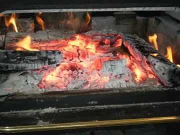

I recieved a PM requesting a photo
of wood stacked in my Liberty.
This was taken about 15 minutes ago.
Note the triangular burn pattern.

Well after about three years now, I can make this baby burn hot. First like everyone says DRY WOOD, OF ANY KIND!!!!!!!!!!
Now I fill it to the gills, when it is cold like we have now. Im down to 3 refills a day at 5:00am went I get ready for work, 2:30 pm went I get home and anywhere from 7-9pm. I let the ashes fill up to the top lip. I move all the coals to right, then push all the ashes to the left and scoop up with the ashtrap. Then respread the ashes and pull the coals to the front. For me the key is to have your wood cut to 21"-23" long, that works the best for me. I hope this helps fespo
