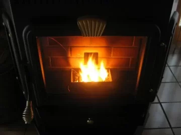

Thanks Beca. Another weird thing that i noticed with my stove yesterday. I read your long post about how you guys run yours. 4 for pellet feed and 1.5/2 for the damper. The flame kept going out. Lowered the damper to 1 and i was still having an issue with the flame pretty much going out. Went down to Lo and started getting a rip roaring fire. Also the glass in mine keeps getting black. About 2-3 inches from the top. if i could guess it would have to do with the damper being so low but then again, i clean it out every day and it's really easy to just wipe off. It was REALLY awesome to not have to run the oil monster all weekend long. well maybe at night, but that's because my wife has a thing about unattended flames. Apparently furnaces don't count. beats me. Over the weekend though, i was in and out of my basement doing some work. It gets stupid cold in there without the furnace running. With the winter getting colder and the oil monster running less often i want to avoid any frozen pipes. I remember seeing some timer that a member here created that will run the furnace on an interval. Can't find the link anywhere though.
Another question for all the pellet brains out there. This might open a can of worms but what kind of flame should i be looking for from the stove? The current setup i have gets the flame roaring and it gets pretty much all the way to the heat exchange tubes. The fire is blue in the pot and bright yellow all the way through. Obviously when opening the damper up the blue flame gets larger, as it well should, and the flames are still "unusually" high. Ash has been consistently gray even in the burn pot (ash from when i turn the stove off and clean it up the next day).

Ice, can't comment on how you should deal with the very high flame.....I never worked on a stove like yours, but the description of the flame/ash seems about right.....you want a bright yellow/white flame, some blue at the base, and greyish/brown ash.
here's 2 pics of what my previous Astoria stove, and my new Englander 10-cpm flame look like during "normal" burning:
Astoria:
