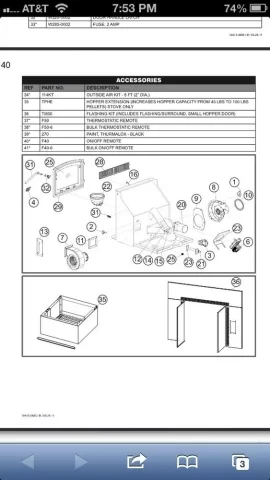

On page 40 of your manual, find item #1 on the exploded view. That is the proof of fire switch. There should be two wires connected to it. Unplug the power cord, then make sure they are both plugged on tight.

I turned to page 40 of my manual and it is a parts and accessories page (the item #s if I need to order additional parts)
Is this the same as your manual page forty?
