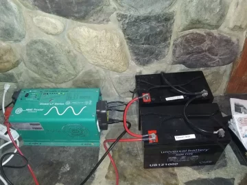

Got my Harmon XXV in April 2018. They were selling floor models. $3500 then. They list for $5,100 now. Worth every penny. Replaced Blaze King King. Don't miss the Wood Mess. I use Fan to push air down hall and supplement heat with Oil Electric heater (Bedroom). So talk to Distibutor and ask when they will sell Floor Models. I use AIMS 1250 Inverter/Charger and couple of 100ah Battery along with 800w PSW Generator (just got Sportsman) for power outages. Longest outage in 10+ years has been 10 hours. Then I had only one 100ah Battery and used 30ah battery to get 10 hours. I Plan on upgrading batteries in 2023/24 with Lithium Ion. 400ah I hope or 200ah. Got some maintence to do on OAK this Spring (Small hole in Stub from Panel. (Will replace or put Metal Tape over it).
