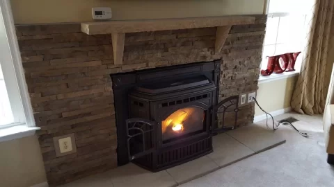

Hello Forum Friends,
I'm a new forum member and new MTVAE insert owner. We purchased the unit to take the "chill" out of the air during the winter with supplemental heat. Our two zone heat pump would keep our home tolerably warm, but we always felt cold even with the emergency heat kicking on. Problem solved with MtVAE!
My question is how to best use the heat pump and pellet insert in concert with each other? I looked into possibly purchasing a Nest thermostat control, but don't think it's 1. possible and 2. worth the money/effort...but I'm completely open to your experiences/suggestions. Any advice you could share on how to best run our insert and heat pump together would be greatly appreciated. The goal is to be efficient with both units and keep the chill at bay.
Other factors- we are in Southern MD where colder temps occur between late October and April. We're burning American Wood Fibers Ultra Premium White Pine (and using more than I had originally thought!). Our home is about 3,200 square feet (above grade) with a somewhat open floorplan and the pellet insert is in our family room.
Thanks for considering my post and I look forward to learning and contributing!
Jojo
