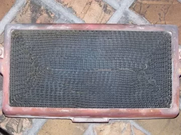

if you plan on getting one for next year,have them double the amount of insulation they send you..the new cat is kind of oval,the frame it goes in is rectangle...you will also have to jam pieces of insulation into all four corners....they told me on the phone the insulation will expand and fill in all the gaps,it will not...but easily fixed with extra insulation.
I hope woodstock figures it out for future users.
No problems with this one. It was kind a loose when I first installed it into the cast frame but it's pretty snug now. My new Keystone has the steel cat and I noticed it was not as loose as the Fireview in the cast frame and seems to be working great.

My new metal cat fit a little loose, but the instructions said it would. I took it out for cleaning yesterday and it was still kinda loose in there. Not worried about it. the stove is burning hotter and longer than it ever did with the ceramic one. It was also unbelievably clean after 2 months and at least 2 cords burned. I just rubbed some dust off it and shook it around a little outside.
