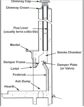

See Anatomy of a Fireplace below.
Most fireplaces provide a natural setting for a new stove,
allowing for use of the existing chimney. Both for safety
and optimum performance of the stove, a stainless steel
liner should be installed up through the chimney from the
stove’s flue collar to the chimney top.
