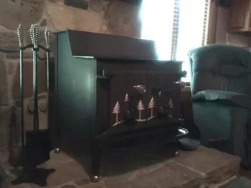

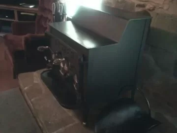

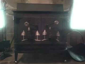

Hey guys, I'm going to pick up a Fisher stove tomorrow and, was needing some info on them. I'll post a couple of pics. The price is 250.00, I think thats pretty good! It looks to be in really good shape. Anything I should look over really well before I commit? If you click on the pics it will show the whole pic!

As long as your area doesn't require a UL Listed stove, you're good to go. Probably a '78 or '79 Grandma from the Dunn Brothers.
Its going in a cabin on my property. No electricity, or roads only four wheeler or side by side access. Just wondering about the price. It also has the screen with it too.
Price is good. Depending on season, that one could be 500 or more. The screen sells on eBay regularly for more than a hundred alone.

As long as you have the stove pictured, single wall pipe is permissible. The arched door with Model III designation requires double wall in horizontal installations. (not just code, but for proper operation as well) You need a damper in the first pipe section as well. 3 screws at each joint of connector pipe as well as at stove outlet. Page 12 in the manual gives masonry chimney requirements. (flue liners are available with precut hole for horizontal connector that cannot extend beyond inner flue wall; Thimbles must be cemented in place; Clean out with at least 6 inches of flue below connection; Connector pipe extending a minimum of 2 inches into flue connector....)
