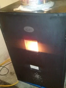

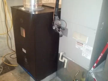

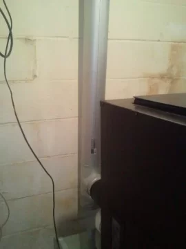

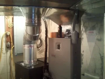

Sure here are a few pics..... I put it right next to my heat pump... I ended up venting through the wall rather than going into the chimney (there was an old wood burner down here years ago).... Guy at local furnace store said its typically not a good idea to vent out a chimney....instructions said it was ok, but I trusted his opinion...

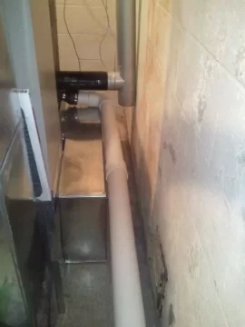

I ended up hooking my outside air inlet into the old chimney plug....I just used 3" PVC to allow for some flow w/o restriction...I used a tee transition from horizontal to vertical so that I can put a thred-in plug in the bottom....I can run it with the plug in or out....not sure why I did that yet other than that I am a geek....
The room the furnace is in is very small....we just remodeled our basement making 2 bedrooms and a full bath down there....so the furnace/utility room is in the back of our walkin closet.... Definitely had to pipe outside air in.

If that Outside air is made of PVC, I would definitely look into changing it. If you lost Power, the air may go through the OAK to find a way out (if the furnace doesn't have a flapper) and end up melting the PVC.
A few members have done it this way and changed it. There is a pic of a PVC system somewhere that is melted and mangled.
The other thing is a surge protector. These stoves have very sensitive electronics on them. Protect your investment with a $20-$30 protector. Tripp Lite makes some good models. Do a search here and you will get plenty of results.
And Backdraft dampers on the existing furnace and on your pellet furnace. They may be there. Just wondering? Cant tell as some dont look like anything hut regular duct work. Looks awesome.
Other that that, looks great. Keep us posted.

Ahhh thanks for that info!! Would have never thought of that....I will have to get the actual kit from the local furnace store..... I was going to use aluminum dryer hose but it was flimsy...
Also will definitely get a surge protector right away...I have a few laying around....
Yes - have backdraft dampers in the duct work...its pushed up so its hard to see....and on the back side I have a slide for the cold air...
Thanks again!
