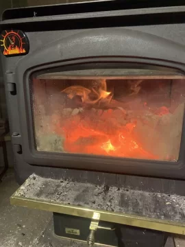

I lite the stove at 8 this morning and put a load on this picture is what it looked like an hour and a half in. Was loaded with 6 small splits. I moved the thermometer onto the top left face of stove. Reads a lot hotter than it did when it was on flue pipe above stove

Seem normal for smaller splits. Not sure what your weather is today. Sometimes a small hot fire will warm the house but I would loaded that baby to the top. And pack it tight like Tetris. What will happen is when it gets up to temperature it will cruise at that sweet spot for hours. Small fires get hot quick but then drop right back down in temp.
Small splits are going to burn faster. There is more exposed surface per pound of wood burned. Thicker splits, packed tighter will burn slower. Also, try closing down the air much sooner, but not to the point of killing the flame.
I see you have a meeco red devil thermometer I would not put much trust in that I bought 2 of them from menards before Christmas I put them side by side on the same stove top they read 100 degrees difference from each other and 200 and 300 degrees lower than my IR gun.
