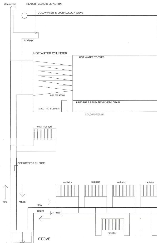

OK thanks for the replies im maybe not in the right place for help but i have spoken with a heating expert over here and we came up with a plan here is a drawing if anyone wants to see how we do thing very simple system but i need to incorporate the hot water for safety as the cylinder coil is gravity feed from the stove to insure safe operation in the event of a power outage on the central heating pump the stove in the poor quality photo is a boiler stove my my current home but is not plumbed its just convection

I have grave doubts as to whether coils in your wood fire would produce the amount of heat that you would need for all those radiators. I tried the same idea before building a proper heater which you can view on this forum at:- https://www.hearth.com/talk/threads...-on-the-design-by-richard-c-hill.68593/page-3
My experience is that coils in a fireplace remove too much heat from the fire which means it will not burn with full efficiency. Additionally, you will get a heavy build-up of creosote on the coils which acts as insulation reducing the heat exchange that you are relying on. I was able to heat a small quantity of water with a two meter coil in the fireplace but as soon as I started circulating the water through the hydronic radiators the temperature fell to a level where it was completely ineffective.
It would appear to me that your best option is to replace your oil fired boiler with a commercially made wood fired boiler which are readily available in Europe.
