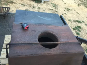

In my spare time I have been cleaning up this Fisher Fireplace Insert. It is awesome! Here are some before and after pics.

Before:
[Hearth.com] New (to me) Fisher Fireplace Insert [Hearth.com] New (to me) Fisher Fireplace Insert [Hearth.com] New (to me) Fisher Fireplace Insert

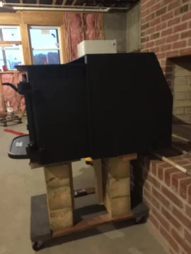

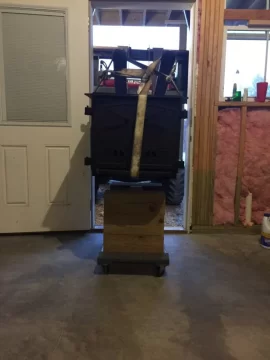

Bringing in the beast!
