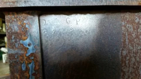

Heres the markings from lh back side
D B G P
5423
Incase anyone is comparing numbers
