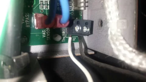

Is there a jumper on the thermostat terminals of the control board?
At the bottom of the board you should see two terminals with screws and a wire bridging the two
The first white and the black wire below it are for the thermostat they just run down and the ends are snipped off from the previous owner
That would be your problem. The thermostat terminals as shown in this diagram (J18) should be jumpered if you aren't using a thermostat.

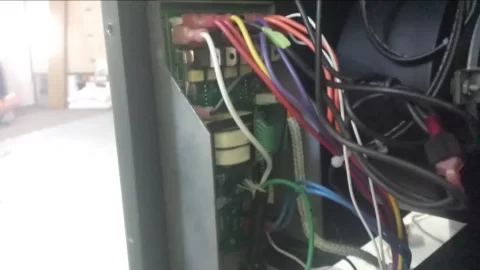

Here is what I found dunno if should be this way

So if I run a thermostat I use those wires to the thermostat and if I don't I just tie them together, that sound right?

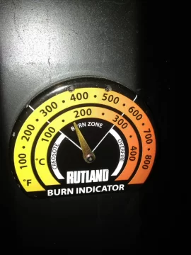

[Hearth.com] new to the 25 pdvc [Hearth.com] new to the 25 pdvc
Get one of these and put it on the side of the stove. It will give you an idea of the heat that the stove is making with the pellets that you have in it. This was with the stove in 'd' mode last year on 2 heat / 3 blower with the lower 3 buttons set to 6 / 4 / 1. The pellets at the time where Maine Choice.
Just for comparison.. running at 3-4 with the bottom 3 at 6-4-1 we are normally at 150-175F burning FSU's, this is measured with the same thermostat CladMaster is using except we have it on the left corner (looking at the stove).

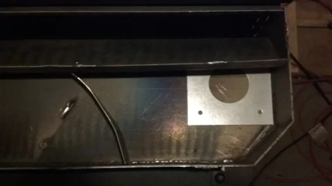

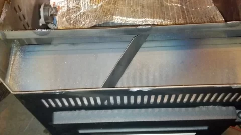

Yea you got me there! Never really think to take pics. until after the job is done.Sorry I, didn't get any of the drop chute but did on the heat exchanger plate.
[Hearth.com] new to the 25 pdvc This is how the plate was when I took the top off.
[Hearth.com] new to the 25 pdvc This is how I re-did it. The plate on my older stove was welded on in this direction. I, added the plate in the right corner to try and push the air around the exchanger a little better. Just below this corner plate is where the fan blows right into the heat exchanger I, find that the plate in the corner helps push the air back around the exchanger instead of straight up and out. I messed around quite a bit with a thermometer taking temps. of the air coming out the front moving the plates around and found this gave me some of the best readings with this set up. It definitely took care of the cold air issue I, was having.
View attachment 122759 This is how the plate was when I took the top off.
View attachment 122760 This is how I re-did it. The plate on my older stove was welded on in this direction. I, added the plate in the right corner to try and push the air around the exchanger a little better. Just below this corner plate is where the fan blows right into the heat exchanger I, find that the plate in the corner helps push the air back around the exchanger instead of straight up and out. I messed around quite a bit with a thermometer taking temps. of the air coming out the front moving the plates around and found this gave me some of the best readings with this set up. It definitely took care of the cold air issue I, was having.
The Engineer in me needs to speak up.
The total heat extracted from the stove is dependent on both the temperature of the convection output and also the volume of the convection output. Maximising efficiency can be approximated by getting the product of (temperature x Volume) to it's maximum.
The problem is that adding objects that deflect the flow always also reduce the volume of air being moved. This is because those objects increase the resistance to flow by increasing turbulence. That same turbulence is what improves heat transfer from the metal surface to the flowing air.
I am not saying that what you have done won't improve the stove's efficiency. It is difficult to predict what will work and what won't. If you don't have a $40K dynamic flow software package, experience is the best guide to design.
