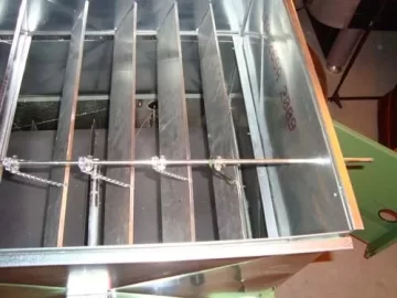

Here's some comments to date and a few pics of the APEX install. Most happy with about everything on this furnace but a few things could use improving. I had it shipped to a dealer in Minnesota and drove over to pick it up. A bit of the paint was rubbed off during transit. You can barely notice it, now it is sitting in the basement. Here's a couple of pics of it sitting on my trailer in the garage.

I had to modify the damper that the HVAC guy installed so that I could keep it open without the blower blowing on the wood furnace. This way the heat feeds the duct work and keeps it warm.
