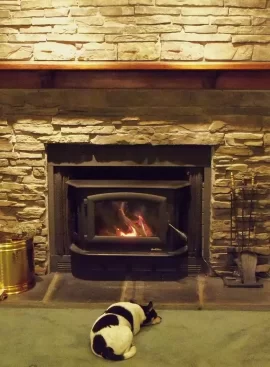

Sorry for the crazy question. I'm new at this and over 1.5 hours from the nearest stove store or I would go there and ask. I'll try to get a pic tomorrow of what I have now. All I have now is a pic of the stove.:)
  • [Hearth.com] Newb Chimney Extension Question
