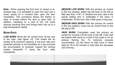

I seem to get a good burn with it closed all the way. The owners manual says not to run with it closed. It says open 1/16”. I have no idea how anyone would be able to judge that.
With a light tap of course ;).
1/16" really isn't going to make too much of a difference in burn time, it'll just supply a little extra air which can be useful just to help keep things humming along. As temps get colder though and stronger draft is produced as a result, you'll probably want to close it all the way if you're already getting good burns. But since it will be colder, you'll probably want more heat out of it, which means opening it up a little bit at the coaling stage.
