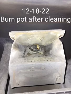

Problems with all the listing I have seen are that they are opinions and no actual data (vendor included), after searching on the web I came up with a gentleman who actually tried to perform an analysis (posted below) and I performed simular. Fully cleaned out the stove, size range of pellets, time to burn 40lbs of pellets, photographed burn pot before and after run, took an average of door glass temperature using a Pyrometer, description and weight of ash after single run (40 lbs).
Stove run at 70 F in automatic mode, turned off during bedtime, and restarted to hopper empty.

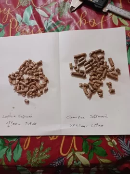

Logik-e softwood Pellets purchased through Pellets Dirrect.com
Purchased August with September delivery
Color lite brown, semi buff exterior
Pellet size between 7.08mm to 29.4mm

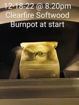

Clearfire Softwood purchased through Wood Pelets.com
Purchased November with December delivery
Color medium brown, glossy exterior
Time to burn = 21hr, 44min
Average Glass Temperature (measured at center) = 545.0 F
Ash Weight = 3.2oz
Ash description = powder
Glas cleanliness = 40% lite brown to black deposits.
Much more fine black ash on all interior sides of stove during cleaning.
