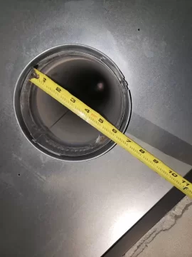

Can I install a 4 in pellet liner in the type b vent that goes up my chimney? the installers are trying to charge me a fortune to install a new chimney saying my vent is only 5 inches, but I measured and it is 6 inside diameter. Also is the outside air vent better or not needed?

I removed the old gas unit. The shell is still in there. The vent pipe is also still there. They want to vent it out the back which looks really stupid since I have a chimney going up. They told me $2000 to remove the old vent and install a new vent since it was not 6 in pipe. But it is

That looks like a class A insulated chimney! If it is just put
a reducer on it and you are good to go. If it isn't I just run a
liner up it as long as it were in good shape
