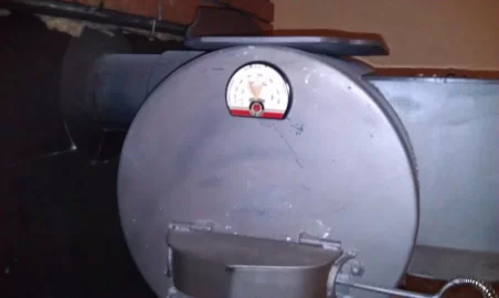

I got a thermometer from a local farm shop and stuck it on the side before I started my burn today. This was the first time I loaded it up for a burn, and it was a GREAT help in figuring out what to do with the dampers. I got a bunch of wood in there once it got rolling and watched the gauge. Once it got up to around 600 I aimed a fan from a cold part of the basement towards the stove and closed a damper and got it down to about 500-550. The basement heated up nicely. It was 46 today, and my room thermometer registered about 66. It's one of the old Da Vinci style ones. I painted in the next room for hours, occasionally adding a stick when the wood burned down to coals.
In many circumstances you'll need to start closing the dampers well before it hits 600, so don't get too settled on that number. With a good load of dry hardwoods, especially if there are other factors in play, e.g. the wood is split small, it's exceptionally cold or windy outside, you're loading new wood onto a large bed of existing hot coals, etc., if you wait until it gets to 600 before you start dialing it down then it may be difficult to keep it in the safe zone. One evening earlier this winter I made the wrong combination of decisions for the circumstance (loaded a bunch of odd-shaped chunks of high-BTU hardwoods onto a large coal bed on a very cold night) and though I started closing the damper at 400F, there was just too much heat being produced too fast and the stovetop was soon flirting with 900F. That's not an experience I want to repeat anytime soon.

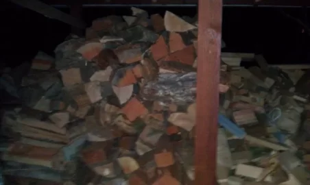

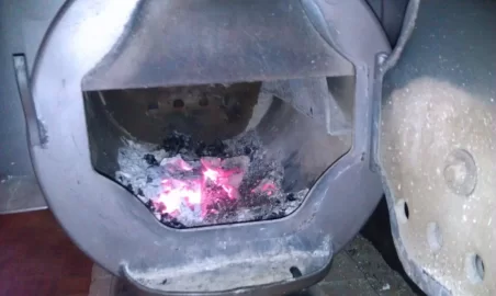

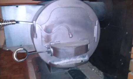

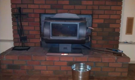

OK, here's some pics of the stove. I think it's steel. Almost rust-free, just a few spots here and there. I got one of the woodpile, too. It was dark when I took the pic... anyway, what do you think? The chimney is exterior to the house. From what I've read that's not optimal, but I'm not going to build another chimney. I don't have that kind of money.

Below, see the pic of the thermometer. I didn't realize until after I posted the pic that you can see the dainty little tomahawk in the upper right.

That's an old ~1980 Orley. Moved to the Classics forum for a more targeted response.
This is a tough heater. There are lots of them in the Northwest. They handle a big long log, thus the left and right air controls. This stove will really crank out the heat, but it will also go through wood like candy. Try to keep at least a 2" deep ash bed in it. There is no magic to damping down this stove that I know of. Burn only dry wood and turn it down enough to be comfortable, but try to keep a low flame going and not to smolder or smother the fire.
