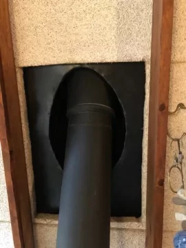

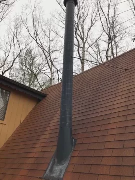

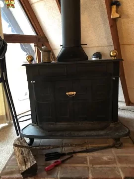

Here are some pics of my existing installation. I've determined that I have 8" single wall to the flashing and double wall after that.

I'm not sure what they were selling, but this could be a DIY install for under $2000.
That stove brings back memories. We had one in the living room from 71 to 85. It ate wood like crazy. Replaced baffle in it several times.

it looks like you have an 8" chimney. Most stoves are made with a 6" collar. If you buy a stove with the wrong size collar, you'll need to switch the chimney.
Now, maybe my eyes are fooling me and you have a 6" chimney. In which case I'd look for a stove made for a 6" chimney.
He's probably looking to keep the same chimney.
It would be ok to hook up a modern, 6" flue stove to the 8" chimney, though I would replace the connector stovepipe with 6".
