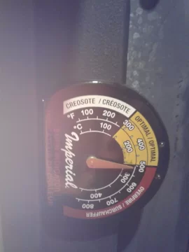

I place a magnetic stove thermometer on the door steel, to the right of the glass. This gives me an idea as to how hot the steel is to avoid overfire. My bottom settings are left to right 6-4-1, but they only effect burn rates 1&2.

Ok, I think the stove may have been in a mode,, praying cuz I want this to work!! Changed to c mode, cleaned the pot best i could with limited tools right now... Restarting the stove. Could you post a pic next time ur cleaning of the holes you said to plug? Thanks for the all the help, to everyone, I don't know how to post without responding to a thread!! Single mom here with limited abilities altho they seem to be getting broader and broader.. Last week I changed a breaker!! Lol
