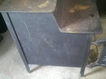

Hey all, figured I should maybe join the forum as I have been lurking for years and am on my 3rd fisher stove, currently heat my bungalow with a baby bear, had a rolled top grandpa bear a couple years ago never used it got it on a trade and traded it off which I have always regretted, but have again managed to acquire a grandpa bear this one is a "76" model 3 piece top, I read somewhere in this forum to post pics of any older 3 piece grandpas so here goes, it does have the round bar seal, which I have to remove the gasket someone put in, just got it yesterday, dimensions are (approx thru old eyes) top plate 29 3/8 x 14 1/2, lower plate 29 1/2 x 10 5/8, body of stove from front to back 23" deep, across the front 28" rear height 31 1/2" top of plate from floor, front plate top 25 1/2" from floor, from what I have been told I am the 3rd owner, was originally bought and put in a local golf clubhouse around 76 or 77, was there until about 2000 then sold and put in a hunting shack until yesterday which I again bartered for and couldnt be happier plus it was delivered and put in place!! Needs nothing, will have it piped in in a day or so, I have seen many different fisher models, but so far no grandpa bear models with the air vents and handle knobs that are on this stove, vents I have seen on other models, knobs I dont think so, as far as I know no alterations were made. Still looking to see if theres any welders marks. Any info would be appreciated. Thanks

Your draft caps (air dampers) are the original 2 inch malleable iron pipe cap. They were drilled in the center and a half inch bolt "plug welded" to the cap with weld ground smooth on the outside. Bob's father Baxter patented the dampers with fins as EZ-Spin to keep them cooler and be able to turn with your foot. It also prevented wear of the threads in door and carbon build up on treads. You don't find them too often on double door stoves since the 4 fin cap became popular before the double doors were built. Baxter's invention sold to Fisher dealers for $4.50 a set. Bob felt it was too much and was afraid fabricators would make their own. That happened in Utah, so other styles are found from the same time period.
