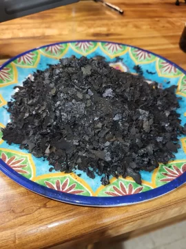

I cleaned the chimney 2 weeks ago with a chimney drill from the bottom and when I burn the stove hot in the mornings I got a good bit of creosote out of it still. Is this normal or am I missing something? Ill try to attach pictures of the cup and a half of creosote that looks like tiny chocolate cereal. Normal or not?

I don't like the quantity for one month nor the shiny color.

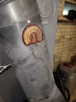

Is your flue temp a magnetic thermometer on single wall pipe, or a probe thermometer in the gas?

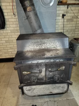

The wire is on the damper because I damaged it somehow after cleaning the connector pipe and it just keeps the thing open till I can replace it. But these are just showing my stove and setup. It feeds into a 10 foot clay flue. The volume calculated to the same as the connector pipe. (Very close.) Also running a baffel that allows a little bigger opening than the flu to allow a little more heat up

I have plans to install a insulated liner and upgrade the stove this summer. But this year, ill have to just keep sweeping more often it seems. I do burn it hot (450ish) for about 15-20 minutes every time I have a cold reload. But on a hot reload, I keep it running 300. Thats why I was surprised about the amount of creosote. It just fell to the clean out door. That wasnt from a sweep.

But that amount of creosote for one month, and its nature is not good. Is the masonry chimney on an outside wall?

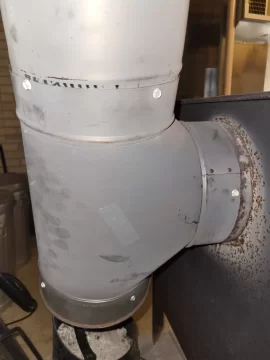

I also wonder whether that connection visible right above the stove in the first pic, has the pipe upside down? Pipes should go male end pointing down (so that anything that runs down along the walls does not leak out).

It is single wall connector pipe. And I made sure they go male end down. The pipe ties into the stove with a clean out Tee. The Tee had to get opened up with a hammer on an anvil to fit over the stove. That was coalys suggestion to fit it to my stove.

Is there horizontal run of the stove pipe before it hits the chimney? That is something that's a draft killer. Also, before wiring the key damper open, was it in use during the month before cleaning? What I'm getting at is, a weaker draft with that masonry chimney will lead to the cresol too.
Is the cleanout door gasketed or sealed? If not, and it's loose and leaky, that may be part of the problem. Cold air being sucked into the chimney can cool down the flue enough so that the creosote starts condensing. Try taping off the cleanout door or create a gasket by closing the door on a bead of silicone adhesive.
