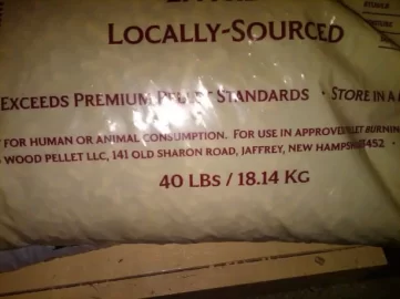

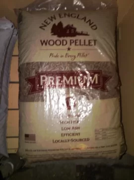

Hello
I just picked up some New England Wood Pellets in a Clear Bag at East Coast Lumber in Hamstead NH.
Has anyone tried these? What does the clear bag mean?
  • [Hearth.com] NEWP in a clear bag?
I believe that they are this years batch. I burnt a ton of NEWP in the same bag. They were a little ashy but burnt well other than that.

Don, does the bag say what plant it came from? Just wondering if those are from the new plant in Deposit, NY.

Hi Pete
Looks like Jaffrey NH

Deposit is not open yet should be soon. They will most likely use the same bag as Schuyler is using that bag also.

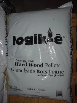

I will let you know how the clear bags work in my Avalon. I suspect I will not have a problem since I burned a ton of NEWPs last year. If you want to try another good Canadian brand pellet then come down to Dodge Grain in Salem for some Logik-e pellets. If you go on their web site and get on the new email list you will get a coupon for $10 off ANYTHING in the store. That means 2 bags of Logic-e for $0.89 a bag. Worth a try if you are around here!

NEWP caught lots of flack(from me included) because of the long pellets from the NY mill. This is a way of showing the buyer the issues are corrected. Well you can see the pellets plain as day! I have seen it by other brands that have an issue or problems. They start putting them in clear bags so the end user can see they are good.
Personally I like the all clear bags myself.

Yes they still have where they were made marked on the bag. They also added a nice little chart for BTUs and moisture and ash. I like the look of the new bags myself. When I buy newp they usually come from the Jaffrey NH plant. Last summer the dealer had a batch from the New York Plant. Im thinking of splitting my tons for the year. getting a ton and a half of newp and a ton and a half of the cubex. Been happy with both but it also depends what the prices are gonna be for the early buy.
