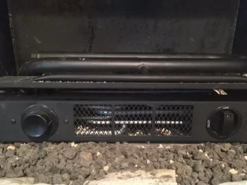

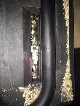

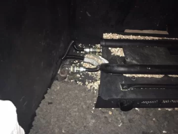

First post to this Forum and really need some advice. I have a Thermablaster 24" Dual Fuel Vented Gas Log Fireplace that was purchased at Lowes a couple months ago. Had it installed in a traditional open chimney mason/rock fireplace that had gas available connected to a burner to start the logs. With the old burner taken out and new Gas Fireplace Set installed, I have only been able to keep the log set on for about 8 minutes once and then pilot went out. I have tried everything I can think of before calling their customer service on Monday. Held both knobs for the extended period of time, made sure thermocouple and ODS Pilot is clear and clean of any debris. Confirmed there is no extra strong draft that is causing the pilot to go out.
Basically the fireplace will work fine if I was to hold the igniter in and turn past Pilot. For some reason as I am in Pilot mode and the hit igniter button the pilot burner and ODS NG Pilot come on fine. They burn a strong blue color and the flame follows the manual by covering all necessary devices. I could leave the igniter button pushed in for a few minutes or 10 minutes, but once I slowly release the Igniter Button its like the gas just stops flowing and the ODS Pilot goes out but the pilot burner stays on. Obviously this will shut it down since the thermocouple is not staying hot.
I have searched and searched all sites possible for the answer but I can't find anything about why the ODS Pilot would go out after slowly releasing the igniter button. The gas flow seems very strong and has the normal valve for on/off function with metal key built into the stone.
I have made certain that hose was installed with no tight turns to restrict the flow of gas, and the air valve on bottom has been turned and locked into place for NG and not LP operation.
