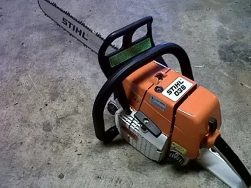

Stopped in to check out the 036. It will be done today. As of yesterday, the Service Manager said its gonna be about $130 (+ or - $10). That's including a set of new Main Bearings. Overall, its not Bad. Mechanic was tapping old bearings out and said I shouldn't have another problem out of this Saw for a Long Time. Will post a rundown of the Bill later when I get home. I could have got it yesterday, but my Son has Football practice everyday and I didn't have an hour to sit there.
$130 aint bad. Could have been worse. Considering what I have in it.
It was $120. New Worm gear, bearing, and springs... I thought he said "Main Bearing" yesterday. Not that bad. But still sucks to buy a Saw off your buddy and put money into it the 1st week.....

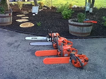

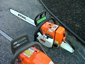

Here is the New pics with the new 20" bar and full chisel chain. Gonna run the Pi$$ out of it tomorrow.....
