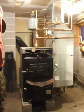

You might look at a royal boiler. Made in wisconsin. Very well built heavy unit, boiler plate steel. I bought a good used one for 1200.00. ANSI certified etc.

In the non gasser genre' it is mighty tough to find anything built better than a Royall. They are ASME construction and use steel that is heavier gauge than most gassers.
I have had excellent customer feedback on the ones we have installed for people. From combustion measurements taken on one near my home (easy to check) I would say they will crank out an honest to goodness 65-70% efficiency or about double most OWB's. They also appear to be far cleaner burning than any OWB I have come across.
You'll find that the firebox on both the FD-42 and the Biasi is much smaller than the Royall and they present more pain when it comes to cleaning and dealing with ashes also. In a perfect world both the Biasi and the FD or Buderus (same thing) might offer a few points higher efficiency but it comes at a cost in the ease of use department.
The Royall line is all fan forced draft (hotter fire faster) whereas the other three are natural draft.
