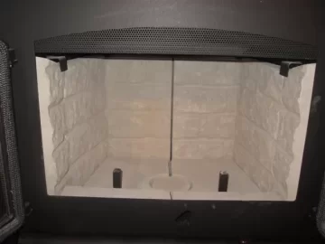

That's great advice guys, I will trim down some pieces now and burn that a few days and see what happens. I currently load this east to west, and I get very long burns, that's not an issue at all. I know this has a pretty large firebox on it, but in order to take advantage of that, and get the long burns, you have to pack her pretty tight in the evening. Doing that means stacking basically two rows, normally three splits high. But it never fails, I always get a split up top in front that ends up falling towards the glass. That in itself isn't a big deal either, although it's in the back of my mind that in a worst case scenario it could break the glass. Also, the gaskets sit up front in the lowest spot there is, so when a split falls down by the doors, it's burning over top the gasket, and I had one go bad already after about 4 months....can't say for sure why that wore out so quick for though, but I suspect the extra heat over top and on the gasket never helped.
The firebox on this is set up so it is 20" wide left to right in front, but it tapers towards the back. In the back, it can fit an 18" split max. That's not allowing any extra room. Seems to work much better and burn much better with an inch or so of air around the wood. I do believe the air comes from the top front. Far as depth, there is approximately 15" from the glass to the back, however, there is about a 3" ledge in front, so really it would have to be 12" long splits at the most for north/south burning. I have no problem cutting the wood 12" long...be extra splitting but if that proves more effective, I'd do it. That would only be for all night burns anyway if it worked.
Most of the time using the fireplace none of this is an issue though, takes just a few splits to keep the box up to temp and throws way plenty of heat like that....I'm just thinking of overnight burns. I'll try some north/south and see what happens. Here's a photo of the RSF Opel 2 firebox....Thanks again....

That is a beautiful fireplace. I broke the glass burning EW in my old stove and generally only burn NS now. Not sure I would burn NS if I had to stack 12" splits though.
This is a long running debate - with lots of people on each side, but really it comes down to the nature of the individual stove - the way it flows it's combustion air through the unit, the configuration of the firebox, loading door style and position, etc... As such, the advice of people that aren't running the same unit that you are is of limited value.
There are a few stoves, mostly ones with nearly square firebox layouts, that can burn either way, but most will have a clearly preferable direction, usually the long direction. Unfortunately, on many stoves this does leave one with the "rollout" problem you are experiencing - and aside from trying to use your more flat sided splits and careful loading, there isn't a lot that can be done about it.
Essentially as others have suggested, experimentation is the only way to find out for sure, but given your stove dimensions, I wouldn't be terribly surprised to find that it doesn't produce the results you want when burned other than the way you are now...
